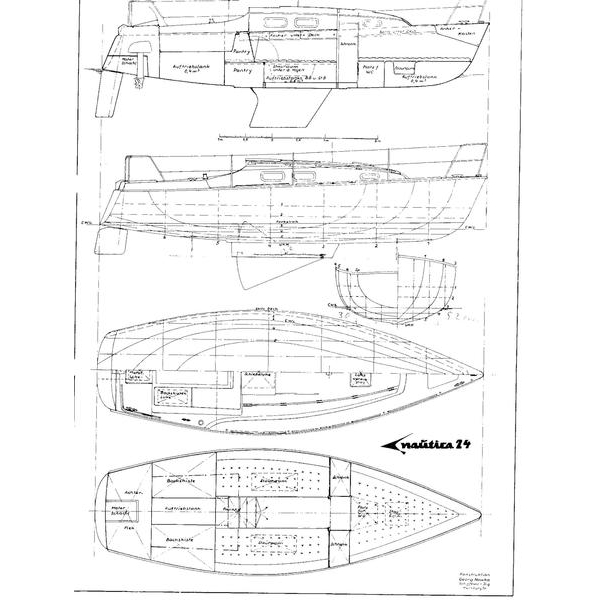

You may want to have a look at the following linesplan from a nautica 24 (second pícture from top). I guess it will answer your question about the keel.

Thank you very much. Shearline. I really appreciate your help posting that sketch of the Nautica 24. Although it's the bigger sister of the Nautica 23, they are basically the same, so it will be really useful for the project.
As I can see in the drawing, the swinging keel doesn't come out as much as I thought it should. Total distance from the helm to the top end of the keel once deployed is 92 cm...looks a bit short to me, but I guess that's the way the boat was designed. I wonder how will she behave up-wind with such a short keel...
Anyhow, next step is removing the stainless steel pin that holds the keel so I can totally remove it and work on the fin and inside the keel box. It will also be useful to see the condition of that pin and if it's bent and needs to be replaced. I have measured the volume of the iron fin and I calculated that the weight is 200kg...I guess I will need some help. Probably a crane again (50 euros/hour)
