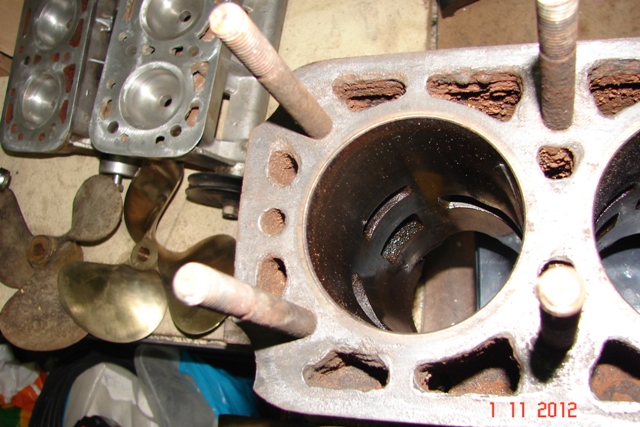

Hi olstad,
have you som photos from the engineroom ?
If it is an 3-cylinder 2-stroke-engine fro an Wartburg, he has 45 or 50hp.
I think, the boot goes up to 40 km/h with them.
Photo: This is an Wartburg-engine in my Lotos I with reversegearbox.
Steffen

Hi olstad,
look at the left Side of my photo
there are 2 original propeller for my Lotos. ~31km/h at 4000rpm with Lewo 20 :http://www.maschinenbau-lehmann.de/FrmSets/Down_02.html
( Bootswendegetriebe Lewo20/25 pdf download http://www.maschinenbau-lehmann.de/D...e%20-%20A4.pdf )
Your filius runs better, the Lotos weighs ~ 600kg , and is 5,5m x 2,07m
- filius 4,7mx1,6m ? 400kg ?
The ..arbor? in your steve tube is an 22mm arbor, korrectly ?
Information to your Filius can you find hier:
http://www.oldieboote.de/navigation/forum.html
and : http://www.oldieboote.de/navigation/...ng/filius.html
I don't know, whether a propeller from a Lotos can good work with your boat.....
Buy a propeller.......hm.....ebay germany, and search "Propeller & Wartburg or
DDR" ( german democratic republic ), use in this forum or in the oldiebooteforum the market.
Greets
Steffen
